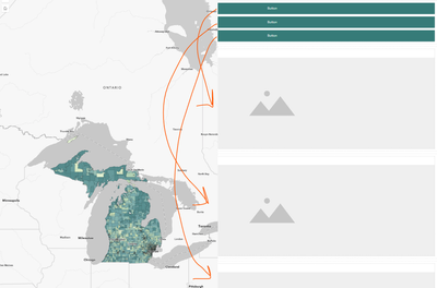

Otherwise, if you stick with a scrolling page, you can "pin" your map widget on one side. That way, you still get access to blocks.
To pin a widget, click on the ellipses that display when you hover over the widget in the page body outline. I would definitely use a % size for this widget to better accommodate different screen sizes, and use a % that will make sense with the 12 "slots" you get when you're configuring a block (I didn't do this in the screenshot, but if I set the pinned map to 50%, then just use the right 50% of the blocks, nothing should overlap).
Adding to this as the devil is in the details:
If your pinned map is set to 100% height, it will cover your header (assuming you have one). To get around this, you can set an offset for the pinned widget (go to Style --> Offset Y). Then, on the overall page settings under Header, check the box to make the header stay at the top of the page when scrolling (otherwise, it'll disappear and you'll also have that offset as a gap). Note that the offset will mean any widgets you have at the bottom of the map won't be visible, so best to either 1) choose tools and a tool layout based on that, or set up the widgets you need in a widget controller that can stay at the top or one of the sides of the map, or 2) don't have the map at 100% height, do like 95% or something.

Hmmm... pinned widgets shouldn't be in a block at all once you pin them. For the button links, I'm also linking to different blocks, not views or screen groups (just want to be clear as all of those terms could conceivably describe the functionality, but they're their own specific things).
Here's a walkthrough of what I did, though I'm doing it over so it'll be a little different:
  1. Create a new "blank scrolling" page.
  2. Drop a column widget* onto the page (it will automatically be put in a block); set both the column and its container block to auto height. Resize the widget to be half the page (this is not done through the style settings, but rather on the page itself; "grab" the side of the widget and resize by dragging; in my case, I want it all on the right side of the block). Ultimately, this will be the "scrolling side" of the page.
  3. Into the column widget, place a few buttons for later.
  4. Duplicate the block that has the column widget and delete the buttons from the copy. For "content," I've placed a text widget and an image widget into the column. Make a couple more copies of this block.
  5. Go back to the block that has the buttons and link to the blocks that have the "content."
  6. Drop a map widget on the page. It will automatically go into a block--that's OK. Pin it and the block will be gone. When it asks where to pin, I've chosen the upper left square of the 9x9 grid of options. Anything on the left should work though.
  7. Go into the map widget's style settings and change width to 50% and height to 100% (if you have a header, here's where you should consider offsetting the map widget to make up for the header, or just don't set the map height to 100%).
*Doesn't have to be a column or even necessarily a layout widget, this is just an example.
Unfortunately, it doesn't seem that you can also pin the buttons that link to the blocks, so as you scroll, those'll disappear. There are a couple options (probably more than this, but this is what I can think of at the moment):
  • Put the button widgets "into" the map (or whatever you've pinned). Might be confusing for users.
  • Put a "back to top" link inside every block.
