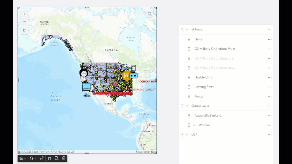

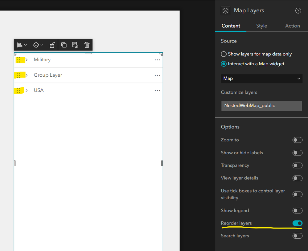

TonghuiMing
You can re-order them in the OOTB AGOL widget, with the following option:
You can temporarily change the grouping by dragging the handler as well:
2024-07-11_11-28-07.gif2024-07-11_11-28-07.gifThis was added in the Mar 2024 AGOL release (supported by API core also). Note that this only is applicable when there is more than one layer existing.
Hope it helps.
ericsamson_tract
This does not permanently change the order of the layers. It is only temporary. Both if the layers are in group or not. Unless I am doing something wrong.
TonghuiMing
Yes, the purpose is to change the order of layers on the fly. This widget would not include the ability to modify the map configurations, that's the capability of web maps - this is the expected behavior.
