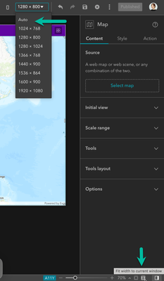

With last night's update, the "fit width to current window" button is broken (see red arrow in screenshot). Now we have to click the zoom out (-) button multiple times. It worked fine yesterday. Today I tested it in Chrome, Edge, and Firefox, so it doesn't seem to be a browser issue. Please make it work again, thank you.

Hi @ccn I was able to reproduce this as well and logged it as BUG-000180356: Fit width to current window button is grayed out and unresponsive in Experience Builder applications
Jianxia
@ccn and all, we have added an Auto size for the large screen mode (desktop) in this release, so the canvas width in the builder is updated based on the browser width by default. With this Auto option there is a limitation to calculate a size to fit to the window as there isn't a fixed size value for reference. We will enhance it in the next release. You can switch to other sizes to activate the "fit width to current window" button.
