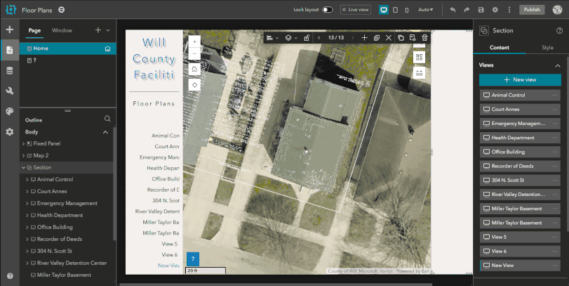

At first it was good. The more I built it the slower it got in both the builder and the display. It's to the point now where ExB is acting very buggy, and I can't go on.
So, the View bug I'm referring to is this: I started with a Quick Navigation template. I'm up to 8 or 9 views in a Section. The last one I added is acting buggy. I tried deleting it, but it won't go away. I've done all the basic trouble-shooting stuff like undoing, closing out, clearing cookies. I'm temporarily providing a copy here.

I don't really know what  was happening, but as I was on a Zoom with Support it "fixed" itself. Support informed me Edge works as a better browser with ExB, and I didn't bother checking this before posting here. But, I did try Chrome and had the same issue. I was using FF when I had the issue. The dev console had some warnings and such, but no errors that I noticed. I guess I'm good now?

I've had an issue like this before. For me, it's been caused by the view in the settings not actually getting deleted from the config.json file that drives the entire Experience Builder. If you were using Developer edition, you could just go to the config.json file for the app, and then delete the view there. However, although you can technically delete the view from the config.json within AGOL by using ArcGIS Assistant, I've noticed that when you make ANY modification to the config.json for the Experience Builder in AGOL, it decides to just completely remove all of the text formatting settings that you had set up in all text widgets, plus some other oddities. Not worth it if you ask me, but it would get rid of the stale view, if that's a requirement.
