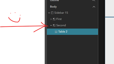

A bit more solution:
Until Esri fixes this unnecessarily automated aspect of the Sidebar widget in Experience Builder, don't just move things around until the "First" and "Second" panels appear. Make sure the "Size" in pixels of your "Side panel" is not too big or too small to engage the First and "Second" panels appearance.  Then, you can safety move things around until the upper or lower half of your screen, or the left or right side of your screen (depending on your sidebar configuration), lights up. Then you drop your window or widget or whatever and it should engage the First and Second Panels.
