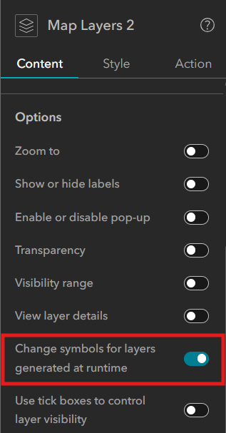

If adding via Add Data WIdget in Exb, how do you change the symbology?  (Points are always only brown dots).

Hi @ABishop,
This functionality is supported within the Map Layers widget (click here to learn more). Add the Map Layer widget to your app, and within the configuration panel > Content > Options, enable the Change symbols for layers generated at runtime setting:

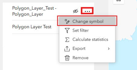

Once you add data using the Add Data widget, and then add this to the map, it will appear in the Map Layers widget. You can then click the three dots next to the data you have added in the Map Layers widget, and select 'Change symbol'.
You can then select the 'Use custom symbols' radio button and edit the symbology of the data.
