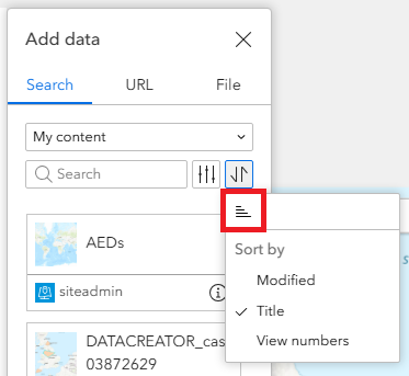

Hello,
Is there a way to have the Add Data Widget be sorted alphabetically A - Z?
When 'Title' is selected for sorting, the layers are sorted Z - A, but I can't seem to find a way to flip it.
Many thanks, Annie
ChrisUnderwood

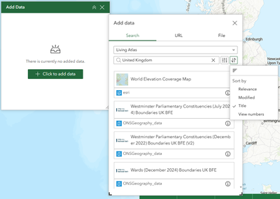

Hello @AMatthews , yes, if you press the little bars icon, you change the order between Descending (like you have) to Ascending.
ChrisUnderwood
AMatthews
Hi Chris, can't believe it was right under my nose the whole time - thank you!

@ChrisUnderwood Maybe a little re-design would make this option more noticeable. Eliminate the divider line in the menu, put Sort By on the same line as the icon and justify the icon to the right. I think this would make the sorting icon stand-out more against the clutter of the other nearby icons and connect the concept better to sorting.
