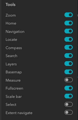

I came to ArcGIS Experience Builder assuming there were pre-built controls for the most common types of map navigation, including zoom (/), pan (⬅️➡️⬆️⬇️), and rotate (↩️↪️).  However, I'm somewhat surprised this is not the case (other than zoom).
Am I missing something?  Here's a snapshot of the available Tools:
The context here is accessibility (WCAG compliance), in particular on mobile devices that are used with a touchscreen.

Hi @zbeat
Thanks for bringing this up.
Even though we do not have an explicit widget on the widget as a tool (might not be considered at this time), the map API has provided various keyboard shortcuts for navigation. When you tab and focus on the map itself, you can:
- Press "+"/"-" key to zoom
- Press the arrow keys to pan
- Press the A/D key to rotate the map
You can refer to more shortcuts here:
https://doc.arcgis.com/en/allsource/latest/visualization/keyboard-shortcuts-for-navigation.htm
Hope it helps with your case.
