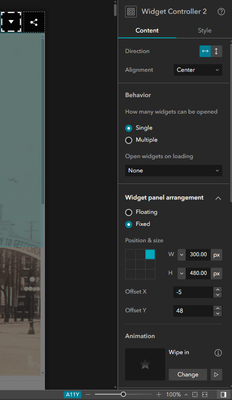

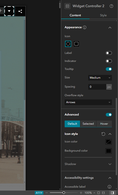

Here's the settings for the widget controller:
Widget Controller Settings_1Widget Controller Settings_1
Widget Controller Settings_2Widget Controller Settings_2

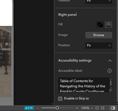

I have yet to add an accessible label; I want to make sure the experience works as intended first.

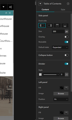

And settings for the "Table of Contents" widget are here.
Table_Contents Widget_Settings_1Table_Contents Widget_Settings_1Table_Contents Widget_Settings_2Table_Contents Widget_Settings_2

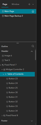

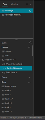

Just for clarity, the "Table of Contents" widget is located under the widget controller in the page drop-down on the left-hand side of the screen, to better understand the structure of this experience.
Widget Structure_1Widget Structure_1

As far as the widget, it is a sidebar widget that has been placed within a widget controller (in a header) with buttons below it. I'll include another picture of the drop-down, in case I'm mistaken about what this is. I inherited this project from someone else and as far as I know, it was moved to Experience Builder because it was originally a storymap.
Expanded Widget Info.Expanded Widget Info.
