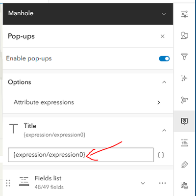

This will be addressed with the June release of ArcGIS Online. The feature title displayed in the Edit widget will come from the popup Title you configured for the layer in Map Viewer, so you'll be able to change it there. This should also support expressions!

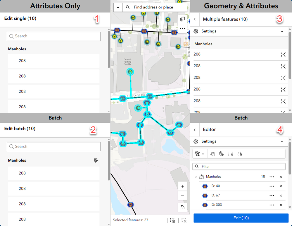

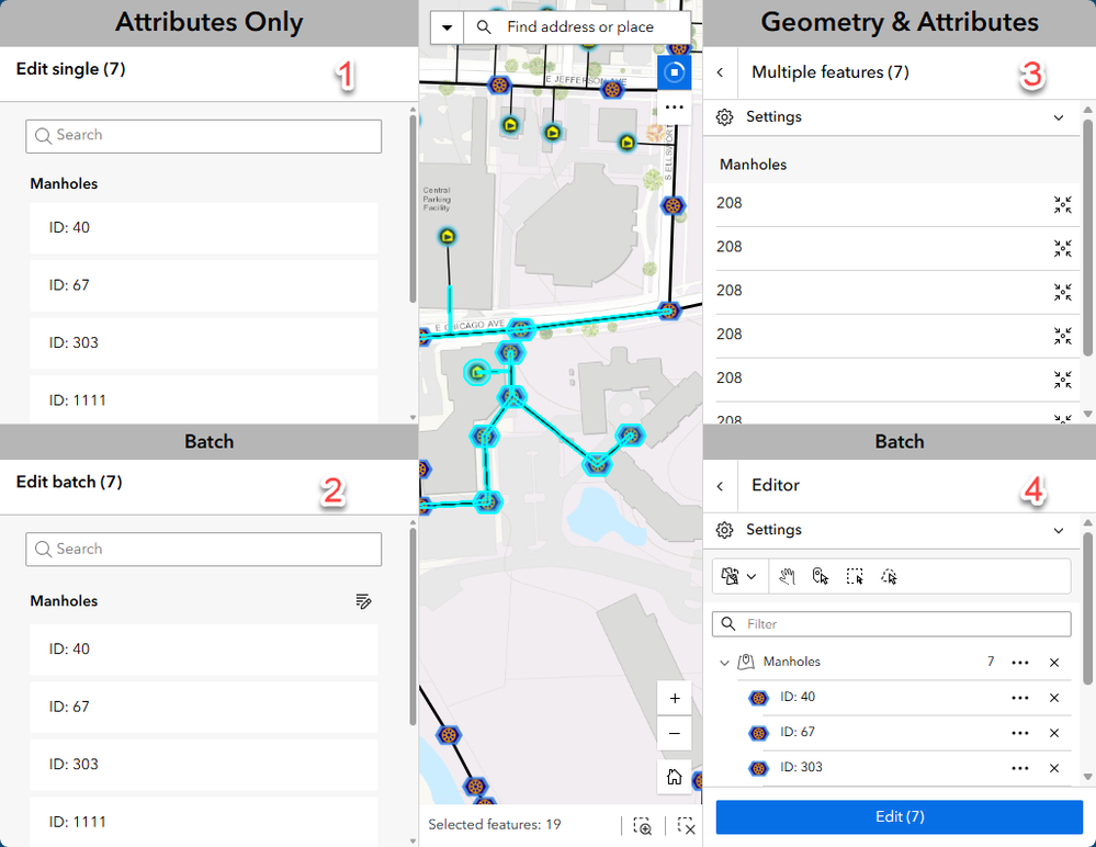

@JosephHilliard94 Apologies, it looks that there are some limitations that remain around this. The feature titles will display as expected when batch editing is enabled in your Edit widget configuration, for the Geometry & Attributes mode only. You can see an example below, where "ID: #" is displayed in case 4.
In the upcoming update, most cases will be resolved except for case 3, where multiple features are selected but batch editing is not enabled.
