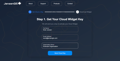

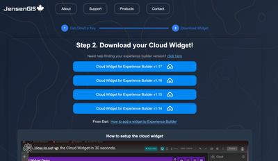

Hi @EdgarRodriguezTM @Hlynur @Bloomers3166 ,
The Cloud Widget is now supported for Experience Builder v1.14 (Enterprise version 11.3) up to v1.17
You can register your organization and download the Cloud Widget for free from my website JensenGIS.com in two easy steps.
Step 1. Enter info and click Send Cloud Key button
Step 2. Receive Cloud Key and Download Cloud Widget
If you have any questions please send me an email [email protected]
Thanks!
Sven Jensen
