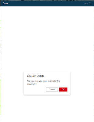

Some feedback I would suggest is changing the dialogue boxes like this:
To be something within the widget. This widget offers a function like this when the user clicks delete.

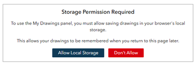

Some feedback I had with working @JeffreyThompson2 on the widget above was adding a user acknowledgment of local storage which the widget above has as well before automatically using local storage. Also a reminder for users that local storage is not a good solution for long term storage.
