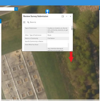

I have a layer in an Experience Builder app that has pop-ups:
Idea: Drag the bottom of the window to expand the pop-up. I want to see more (or all) of the fields at the same time.
2 Comments
Laura
by MVP Regular Contributor
Ke_Xu
by Esri Regular Contributor
Hi @Bud and @Laura,
We have communicated with the JS API team, and this is currently a limitation. There isn't a way to manually change the size of the Popup. Since it lives within the View, it is recommended not to let it take up too much space.
As an alternative, we suggest using the Feature Info widget. However, Feature Info currently has a limitation: it only displays information for the topmost layer. Please track enhancement request ENH-000154737: Feature Info – Allow displaying multiple selections like Popup.
In Web AppBuilder, the Popup includes a maximize function. If this can address part of the issue, we can further evaluate it.
Please Feel free to discuss.
