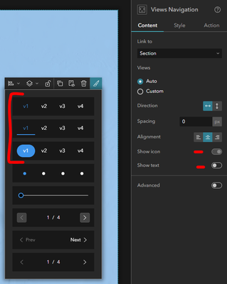

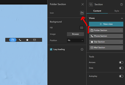

You can achieve this using the "Tab" style in Views Navigation widget.
1)  Activate "Show icon"
2)  Deactivate "Show text"
3)  Change the icon for each of your sections as desired
