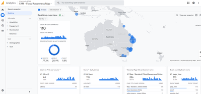

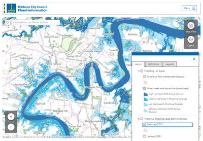

FredericPoliart_EsriAU
@PeterKnoop yes it works on my page.
We've gone live (soft open) https://fam.brisbane.qld.gov.au

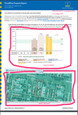

Kara_Shindle
@FredericPoliart_EsriAU Nice app!  Do you mind sharing how you got the "Techincal FloodWise Property Report" to generate?  I'm interested in doing something similar.
PeterKnoop
@FredericPoliart_EsriAU when I look at your app's source, I see that the Google Analytics script is in the <head> of the HTML page, not as part of a Experience Builder Embed widget, which would put it in an <iframe> in the <body>. Did I misunderstand your original suggestion, which I read as using the out-of-the-box Embed widget in Experience Builder?
The suggested Idea here was also meant for the regular Experience Builder environment, not the developer edition. It looks like your site was built using the developer edition, which means it is easy to insert the Google Analytics script in the <head>. I don't believe you can do that in the regular edition, or is there something I am missing here?
Thanks!
Thanks @Kara_Shindle .
The FloodWise Property report is generated like this:
1. We create another separate ExB app that has just one huge custom widget (imagine a widget that is the width of a piece of paper and tall like 6 pieces of paper)
2. Inside that widget we nest a standard Map Widget (to show the map and zoom-to property)
3. Inside that widget we have an area of bar-graph showing the property's highest and lowest level, together with other metrics values. It is basically a JavaScript canvas that draws the bar chart;  The axis are dynamically calculated based on the height of the bars in the bargraph.
The ExB also consumes a web map table, called "metrics" - we query that table to render the bar graph in JavaScript.
4. Once the html is rendered, we use a lambda process (hosted on AWS) to convert it to PDF and return it to the client.
@PeterKnoop   correct,  we pre-load google analytics on startup in the <head> but then we also have hidden <embed> tags throughout the experience builder app.   On Google Analytics we get a bit more information on specific sub-pages .
