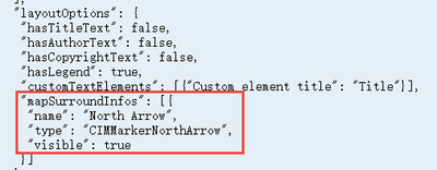

Can you double-check if your print service supports the north arrow? It can be found at the print task Get Layout Templates Info:
If the print service does support the north arrow, please go to the print widget settings - template configuration and see if the option "Include north arrow" is checked.

ShengdiZhang
@AnthonyWillis Hi, this feature is added in the Portal 11.1 and Online 10.3 (November 2022), that's why you cannot find it in Server 10.8.
