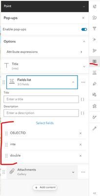

SumitZarkarCT
@MelissaSullivan
If you are talking about the Feature Details shown when the closest feature is found, then this can be controlled from WebMap popInfo. You can edit the the Pop-ups using MapViewer to show the required feilds.
