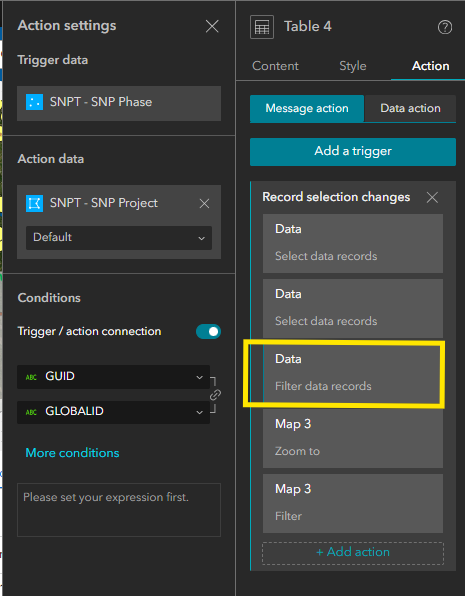

 I have an Experience Builder app in ArcGIS Online. The primary layer in the app is the Project layer which is related to the Nomination layer on GUID/Global ID. A nomination can have multiple projects (a project can have only one nomination). Using a filter widget, I filter the Projects table, and I would like the Nominations table to automatically filter at the same time. However, I cannot get the Nominations table to filter when the Project table filters. There is no option to action in the filter widget to filter data. I have an action setup in the Projects table - When Record selection changes -> Data -> Filter Records and connect the Projects and Nomination on GUID/Global ID. See the attached images (in the action image  SNP_Phase = Projects layer and SNP_Projects = Nominations). Does anyone have any suggestions?
Many thanks!
PS. My first option was to do this project in Dashboards, but the table widget in Dashboards does not allow you to sort or search. My 2nd option for this work flow was to create a joined table using a data expression, but the table widget no longer sorts and the search option no longer works when using a data expression and the data was slow to load with the data expression despite limiting it to the records and fields that I needed and no geometry.
WorkflowWorkflowActionAction

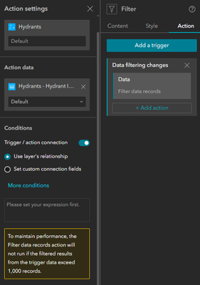

In the latest Feb 2026 AGOL release, we support selecting and filtering data records using the "Data filtering changes" trigger. This enhancement allows related layers to be filtered automatically when a filter is applied to the parent layer.
Please note that there is currently a limitation for performance considerations: the action will not run if the filtered results from the trigger data exceed 1,000 records.

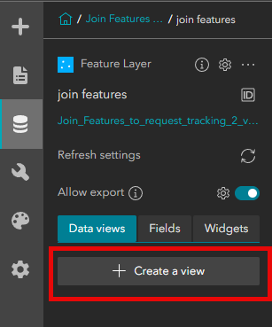

@LJackson29Experience Builder is data-centric. If you only want to filter certain widgets, you can create a data view and apply the filter there. Then, select that data view for the widgets where you want the filter applied.
