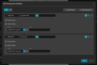

Maybe you should build a pair of clauses? Something like this.
