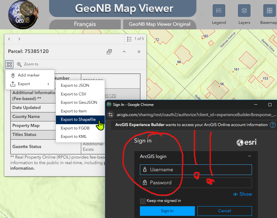

I was excited to see Shapefile exports added to ArcGIS Experience Builder in the June 2025 AGOL update.  Our users need a widely supported format for exporting a few features to be used in CAD or other software. However, after a quick test in the GeoNB Map Viewer (https://lnkd.in/eNam9NC) I was quickly disappointed.
The user must have an AGOL account to export a Shapefile. We share most of our map viewers with the Public. We cannot expect members of the Public to have an AGOL account just to receive a tiny Shapefile.  Users can still download a CSV, JSON, or GeoJSON directly to their computer.  However, exporting to Shapefile, FGDB, or KML requires an AGOL account.  I cannot imagine a scenario where this makes sense.

Currently, exporting a shapefile from the selected records needs to create an item, that is why we need to log in.
berniejconnors
@JunshanLiu why is creating an item required?  The feature identified in the pop-up window is coming from a service (map service, feature service, etc).  My web browser has access to the feature. Why can't the geometry and attributes be extracted and packaged in my browser and made available for download to my computer?  It does not make sense that some formats can be downloaded and other formats must be items in AGOL.

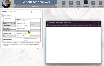

@ShengdiZhang  - Unfortunately, we primarily publish map services so the improvements to Shape File export do not solve our problem.
Additionally, the process to login to AGOL to create the Shape FIle as an iten in AGOL no longer works.  In Chrome and Edge I get a new browser window for the AGOL login but it is either blank or it turns blank after I enter my AGOL credentials.
