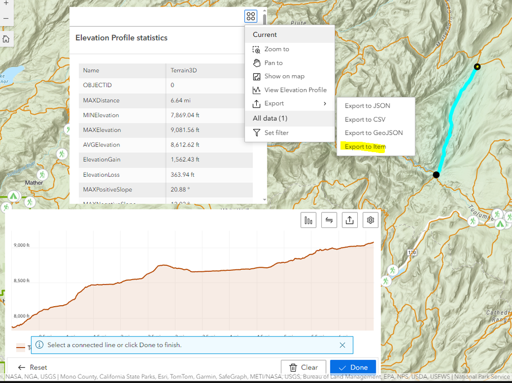

AlixVezina
@חנניהוייסלר
With the upcoming June update, you'll be able to export the profile line to your Content with the attached profile statistics. This will create a feature collection item that you can then publish as a hosted feature layer
To do this, you can connect another widget to the Elevation profile statistics output data source and use the Export to item action. This will export the profile line segment along with its statistics.
For the ability to upload/add a line feature and get an elevation profile for the line, we're looking into supporting this in the following update before the end of this year.

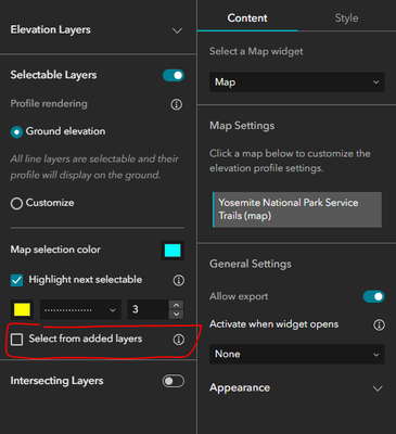

For this, you need to enable the Select from added layers option and upload a line to the map using the Add Data widget. You'll be able to select the line added using the Add Data widget with the Elevation Profile Select line tool.
