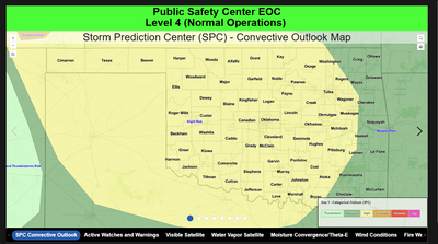

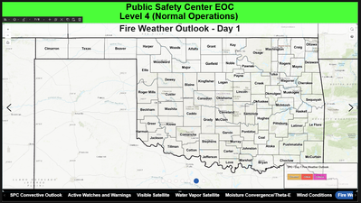

It would be great to be able to show/hide sections in the sections widget. It would also be nice for an end user to be able to interactively show/hide sections as well. This would be similar to how you can hide/show the pages within a ArcGIS Instant App portfolio list.
I have a need for building out a Situation Ops Briefing solution that can loop being the different section views showing the selected information relevant at the time. Automatic looping section views is already a feature and I already have this implemented in my Situation Ops Briefing solution, but threats are different from Daya to Day and Week to Week. Sometimes it's a wildfire risk, other times it may be a severe weather. Being able to have all the content in one Experience Builder solution and being about to just hide certain sections/views on the fly would be a great feature improvement. This would allow a one-stop shop solution for my Emergency Management Agency that is adaptable to any situation.20260623_SituationOpsBriefingScreenshot.png

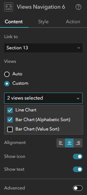

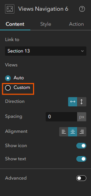

NicoleJohnson
Did you try this? You can customize which views are available to the user:
