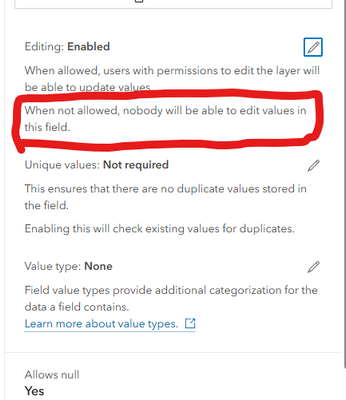

Neal_t_k
Not sure if this follow through to EB.  In AGOL go to the data tab, click fields, select the field you want to restrict.

DougBrowning
Changing these editable settings in a Form does not block them from simply editing in the attribute table or in Pro.  Or open the service in a new map and edit.  Only safe way now is a database view.
More info here plus a script to turn them off  https://community.esri.com/t5/arcgis-online-questions/turning-off-editing-field-by-field/m-p/1695946...
