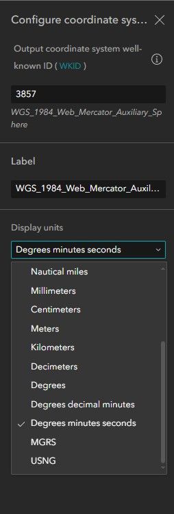

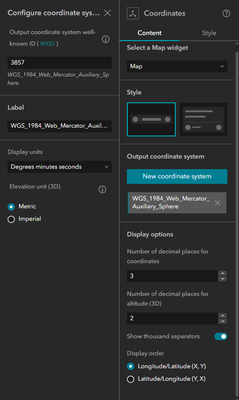

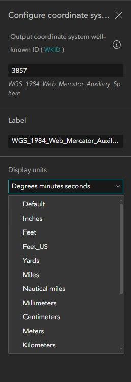

Thank you for submitting this idea! There should currently be a way to adjust the output coordinates notation from the Coordinates widget in Experience Builder by following these steps below:
  1. Open the configuration pane for your Coordinates widget.
  2. Under Output coordinate system click the grey box with your current coordinate system.
  3. Under Display units change from Default to your desired output notation, such as Degrees minutes seconds.
  4. The Coordinates widget should now show the coordinates in the desired output notation.
Screenshot 2025-12-08 121847.pngScreenshot 2025-12-08 121847.pngScreenshot 2025-12-08 121900.pngScreenshot 2025-12-08 121900.png
Let me know if the steps above work on your end to display the correct coordinate notation!

Hi @Charles_Blanchard,
You're absolutely right. I see where I went wrong now. I simply didn't scroll down the list to discover the coordinate formats underneath the distance units!
Thanks for pointing it out!
