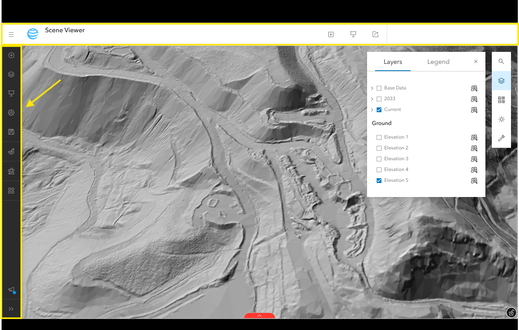

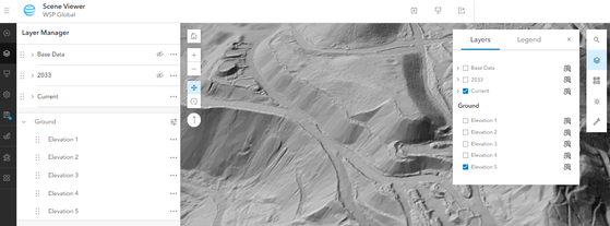

Is there any way to keep the ability to select which ground elevation you want to display for the Scene Viewer? In the actual Scene Viewer itself, in the TOC there is the ability - but as soon as you put the exact same scene viewer into either an app or you link to an ExB, the options for Ground Elevation disappears?
Scene Viewer TOC (option for Ground Elevation to toggle options on and off in both TOC and Layers on Mapframe - correct):

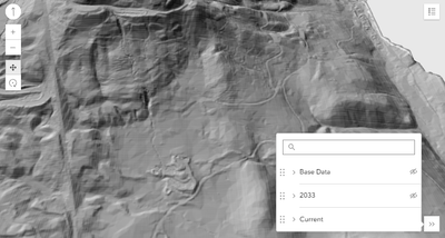

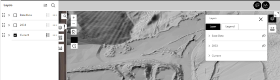

But if you insert as a Map Widget in an ExB or even have the with a Layer widget connected to that same Scene Viewer, then you lose the ability to toggle on and off the ground elevation layers:

Does anyone know of a workaround to get the Ground Elevation options to show up on the TOC?
