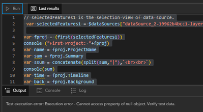

I've been playing around with the newly added Arcade functionality and I've run up against a frustrating issue. I have a text widget that is configured to work with selected features from a particular layer
// selectedFeatures1 is the selection view of data source.
 var selectedFeatures1 = $dataSources["dataSource_2-19962b4bcc1-layer-12-selection"].selectedFeatures;
var fproj = (first(selectedFeatures1))
console ("First Project: "+fproj)
var name = fproj.ProjectName
var sum = fproj.Summary
var ssum = concatenate(split(sum,"|"),`<br><br>`)
console(sum)
var time = fproj.Timeline
var back = fproj.Background
var sback = concatenate(split(back,"|"),`<br><br>`)
var contactName = fproj.CityStaff_Contact
//var contactPhone = fproj.CityStaff_Contact
//var contactEmail = fproj.CityStaff_Contact

Here's the rub: if I don't actually have a feature selected while I'm working on this code, it fails to evaluate and will not insert.
Now, if I go into Live mode and select a feature, then leave Live mode and enter the Arcade editor, it will successfully evaluate and insert. This is an issue because someone could very easily write great, correct code, and will be presented with a very unhelpful error and a widget that wont even accept all that they just wrote. It's not immediately clear that not having a feature selected is what throws this error either.

ShengdiZhang
This is an example of the best practices described in the documentation:
Advanced formatting guide.
Right now, it can be hard to figure out why the script isn't working. If the return type isn't valid, the application may still fail in other ways, so we must let the code insert safely.
Workarounds you can try:
1. Return an empty object when no selection is made:
if (Count(selected) == 0) { return {};}
2. Enable live view, select a feature, then add your Arcade expression
Thanks,
Shengdi
