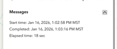

Analysis widget does not display messages from arcpy.AddMessage.  This works in ArcPro and worked in WAB.
It is making it hard to troubleshoot an issue I am seeing with Boolean parameters.

I tracked this down now.  ExB defaults to Warning messages only - even if the tool was published set to Info. So it is not picking up that setting like WAB did.  You must go into the Analysis widget and set it to Info manually.  Not sure if this setting is new as I had not seen it before.
