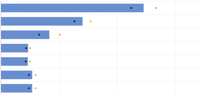

I'm giving this a kudo as I would also really appreciate being able to display confidence intervals in a traditional way, but if you're at all interested in a non-traditional way, you can use the new combo chart capability to sort of do that.
The blue columns represent categories of a thing, the black dots represent the lower bound of the confidence interval, and the yellow dots represent the upper bound of the confidence interval:

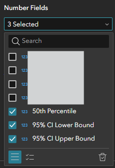

Have your lower and upper bounds available as fields and select those along with your main measure:

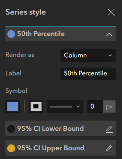

When you format the series, make your main measure a column:

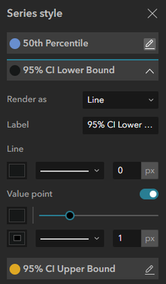

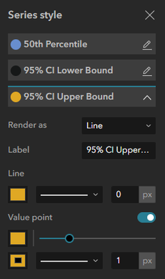

Then make your error bounds lines with a 0 pixel line width:
Be sure to include a legend with the chart.
