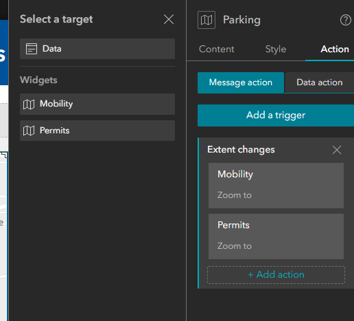

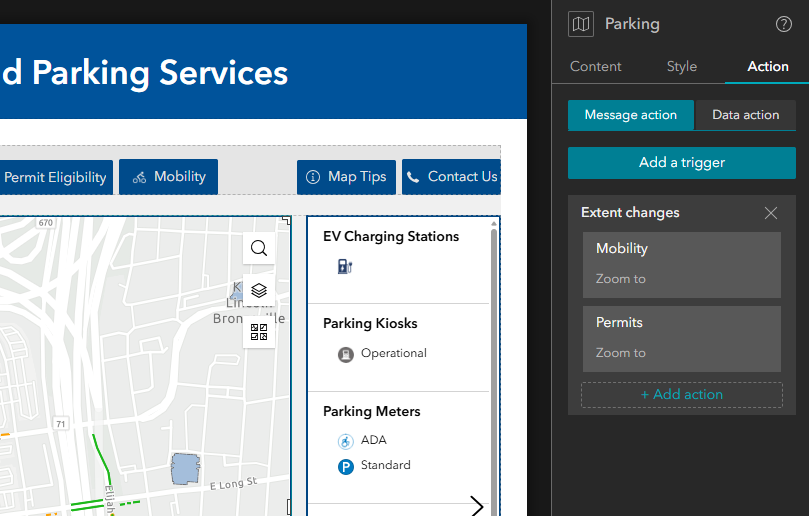

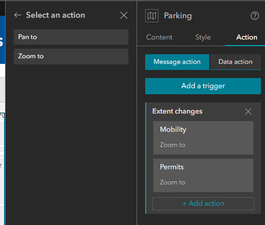

You can do this by clicking on your map and creating a Trigger under the Action tab to pass the extent from one map to another.  I have this setup in an EB I created for our public facing Mobility and Parking map.  Here is the link:  Division of Mobility and Parking Services to see how it works in the different linked maps.  Under the Action tab, click on Add action.  In the side window that opens select the map widget you want. Then in the new window that opens, select the action of either Pan to or Zoom to.  Hope this helps!
