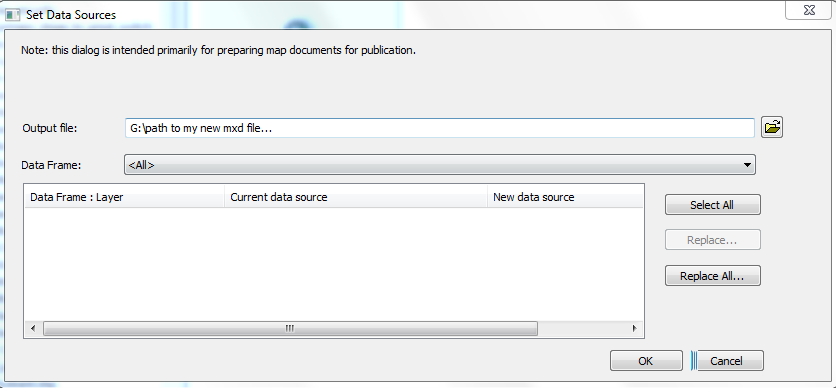

And if that doesn't work check out the data sources in the MXD through ArcCatalog's "Set Data Sources" thing.

With ArcCatalog --> Set Data Sources I get the same information: no layers or tables in the mxd.
