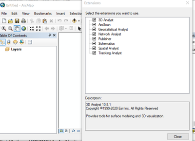

Hi, I have the Advanced ArcGIS extension, but I still get the same error 000824. Do you mind helping me a little bit? Thx!
Here is my error:

Here is my extension window:
mody_buchbinder
Try to run the tool in foreground (on the geoprocessing option menu there is an option for this).
It sometimes solve such a problem.
