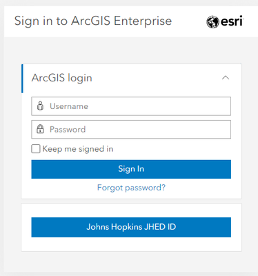

Thanks @BillFox , yes I am aware that both built-in and SSO can be enabled at the same time and when that is enabled the UI appears that allows user to pick.
What I am wondering is if there is a way to sign-in as a built-in user without this UI appearing? i don't want to give users the option because when i do, they try to enter their SAML SSO credentials into the ArcGIS login section and that fails. When the built-in option is disabled, the users are immediately signed in via the SSO SAML just when they visit a map or app and don't have to click this experience.

you could ArcGIS Server's admin directory like that but as far as I can tell anything portal-ish prompts that dialog
