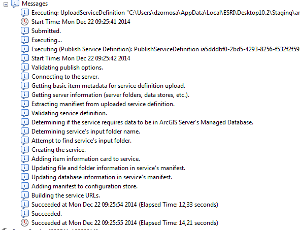

Hi, thanks for your quick response.
I get this. As far as i can tell, there is nothing wrong.
BrandonKeinath1
Deactivated User
I would agree that it seems to be working fine.  Are you able to login to the ArcGIS Server where the service is running?  If you take a look at the logs portion of the site you should be able to see the job submission and get some more information on what went wrong.
