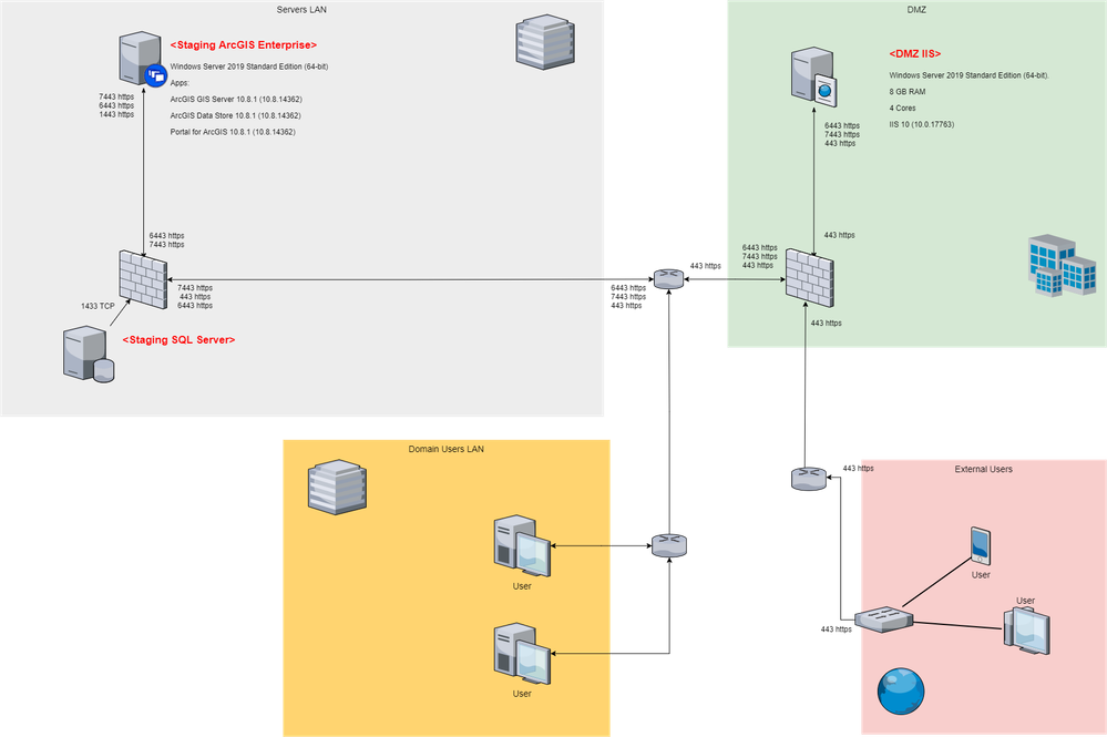

Hello,
Its possible configure a reverse proxy in IIS that works fine having one rule for portal (/portal) and another for ArcGIS GIS Server (/server)?
We need that IIS works as a reverse proxy (URL Rewrite is used), and both Portal and Server use different context (https://domain.com/portal > Portal and https://domain.com/server > ArcGIS GIS Server [with full functionality, just as if you were using Web Adaptor]).
In Azure we have something similar (I include the web.config), the difference is  the name used, in this case /arcgis is used for both applications (https://domain.com/arcgis/home > Portal and https://domain.com/arcgis/manager - https://domain.com/arcgis/rest/services - https://domain.com/arcgis/admin etc for ArcGIS GIS Server), that configuration works normally; but it is not the required in this case.
This is the environment:
1x ArcGIS Enterprise 10.8.1 on a Windows Server 2019 Standard  (Portal, ArcGIS GIS Server and ArcGIS Data Store) (on the LAN) and 1x server (DMZ) in Windows Server 2019 Standard with IIS 10.0.18362.1 (ports are open etc.).
I have tried several things, some work partially but I have not yet found a configuration where the whole environment works fine.
web.config

11 Replies
CraigRussell
Hi
Will internal traffic hit the ArcGIS Enterprise machine directly, or will this also go through the DMZ?  The reason that I ask is that Portal only supports one DNS, so you can't have internal traffic going to https://portal.domain.com/portal and external traffic going to https://external-portal.domain.com/portal.  The ArcGIS Server URL used for federation needs to be the same for internal and external traffic as well.
lvargas
Hello @CraigRussell
Thanks for reply.
- Will internal traffic hit the ArcGIS Enterprise machine directly, or will this also go through the DMZ?
Internal and external traffic use the IIS (https 443 TCP) in the DMZ. Internally they have a rule for 443 and registered DNS name (https://external-portal.domain.com/portal) so, on the LAN can resolve the name  external-portal.domain.com
- The reason that I ask is that Portal only supports one DNS
Yes, they use only one DNS name; the external/public.
- so you can't have internal traffic going to https://portal.domain.com/portal and external traffic going to https://external-portal.domain.com/portal.
Yes, we wil use only the external DNS assigned.
- The ArcGIS Server URL used for federation needs to be the same for internal and external traffic as well.
Yes, internal and external traffic use the same DNS, in this case https://external-portal.domain.com/ (WebContextURL its configured for Portal and ArcGIS GIS Server).
A test environment is currently being used to check the requirement. They wants remove the current Web Adaptors (/portal and /server) and use the IIS like reverse proxy.
We tried use a configuration similar to one we have in Azure (it uses IIS as reverse proxy, no Web Adaptors), the differente is the context name used. For AGE 10.4 - 10.1 ESRI Cloud Builder for Azure use /arcgis for portal and server (previous web.config commented). So we have not been able to configure the redirection properly since the required differents contexts (/portal and /server are required and not /arcgis).
The new wizard to deploy environments in Azure can have diffents contexts names, Portal as /portal and ArcGIS Server as /server (for example, we can customize new names for an Image Server /image if a new server its added), but this its using Azure Application Gateway, now they are not using the IIS, so its different and I cant used for example in the end user enviroment 'cause are not Azure servers.
I have been modifying the rules etc, but have not get the whole environment working correctly without errors / issues, so I was wondering if anyone has configured the AGE via IIS using it as a reverse proxy.
Regards.
