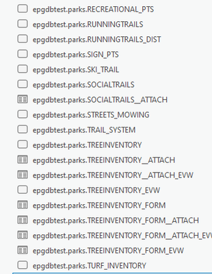

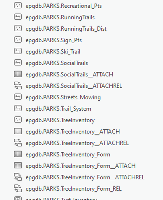

So I have a bit of a follow-up question after starting this process out. My Network Admin and I backed up our main egdb, restored it on the same server under a different name, and my thought was to publish out some services, upgrade the test gdb and see what happens. I'm running into some behavior I didn't expect, and though I suspect it's just a problem with initial database creation, I'm not exaclty sure what I missed.
Here's a sample of datasets in our existing geodatabase as seen in pro:
and here's what I see after making the sde file to the new database:
The icons seen in the second snip appear the same as when I, for example, make a sql view but it's not yet registered with the geodatabase. I don't need to do that for every single feature class do I? Attempting to drag any of the feature classes in the test gdb to the map gives me the crossed-out-circle icon indicating it can't be added.

MarceloMarques
@ZachBodenner
You cannot restore the SQL Server Database with a different name if the ArcSDE Geodatabase Repository Version is 10.8.1.
You must create another SQL Server Instance on the same SQL Server Machine or in a different Machine and then restore the SQL Server Database with the same name.
Otherwise, if you rename the SQL Server Database you break the ArcSDE Geodatabase Repository, for more detail read the articles below.
How to Move the SQL Server Enterprise Geodatabase with a Database Backup
