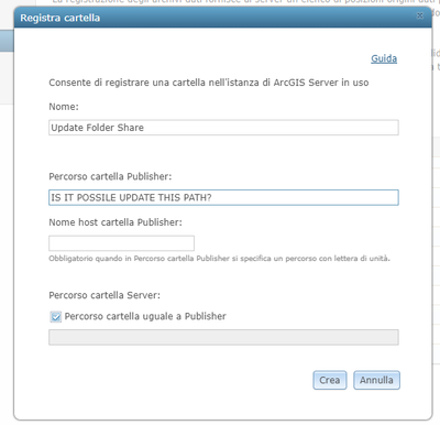

Hello community,
I have a folder already registered on ArcGIS Server.
is it possible to change/update the UNC Path?
ChristopherPawlyszyn
Updating a registered folder path does not update each published service's workspace path that depends upon it. If needing to update those paths, services will have to be republished with the updated paths in the map document/project.
