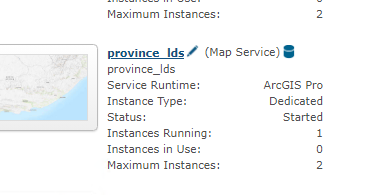

I am currently in a migration process where we have two parallel HA environments installed on 10.8.1. We have used webgisdr to migrate the content from environment A to B which was successful. However, we are also migrating to a new database, but are having issues with updating the database connection.
The process to update the underlying connection string involves importing the new SDE connection file under the Site -> Data Stores tab for the existing registered data store entry, and restarting the services. To my understanding the services should be restarted with a new database instance, but unfortunately the services are still connected to the old database when we examine the database icon:
This has not been an issue previously.
Does anybody have any experience with updating the .sde connection file or any idea on how to move forward in troubleshooting this?

You need to update the SDE connection in the Pro project that is the source of the mapservice as well.

Thanks for sharing. We have experienced that we don't need to script and the connection is updated after restarting. However, the last time we updated the database connection all the services was published with ArcMap runtime. Now, all the services are republished with ArcGIS Pro. My concern is that ArcGIS Server 10.8.1 is incapable of automatically updating the connection string in documents published with Pro.

@LiveHus wrote:
To my understanding the services should be restarted with a new database instance, but unfortunately the services are still connected to the old database when we examine the database icon.
I think it's just showing you the old label for the SQL instance, however the services are actually updated. If you read the comments in the previous link I shared, it discusses the same. Check here.
Maybe as a test, stop the services for the old database and check whether the Map services are working properly or not.
