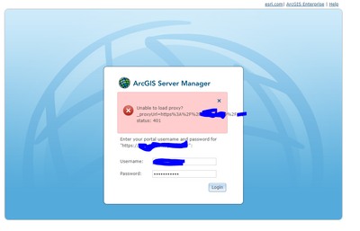

AprilChipman
I get to the Server Manager using https://(machinename).(domain):6443/arcgis/manager and it takes me to this page (when logged onto the server under the username that installed the server software):

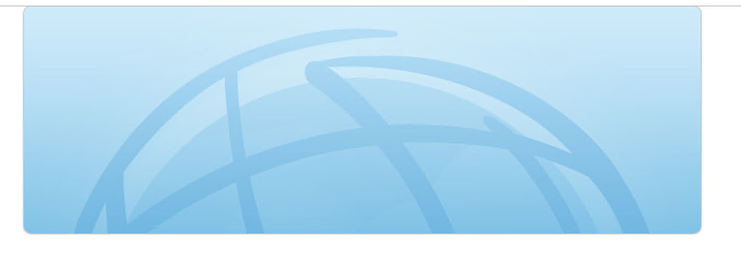

When I go to the Administration URL you listed above, I get an image of half a stylized blue globe/sphere.

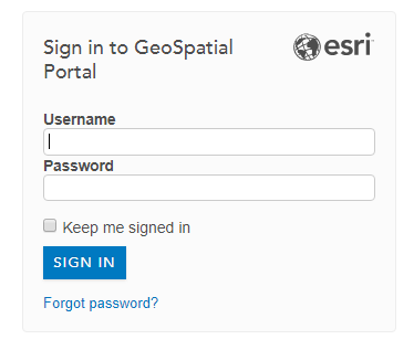

HarroldSompotan
If you are accessing https://machinename:6443/arcgis/ you will get that splash screen. That is an expected behavior.
If you type in the full address with arcgis/manager or webadaptorname/manager, then it should re-direct you to the portal login page that you see above.
