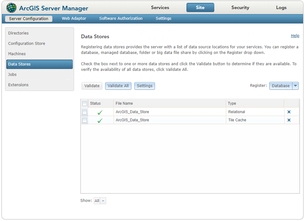

Following on from the above the Data Stores may have registered ok. I see the following when I login to server manager and they validate ok.

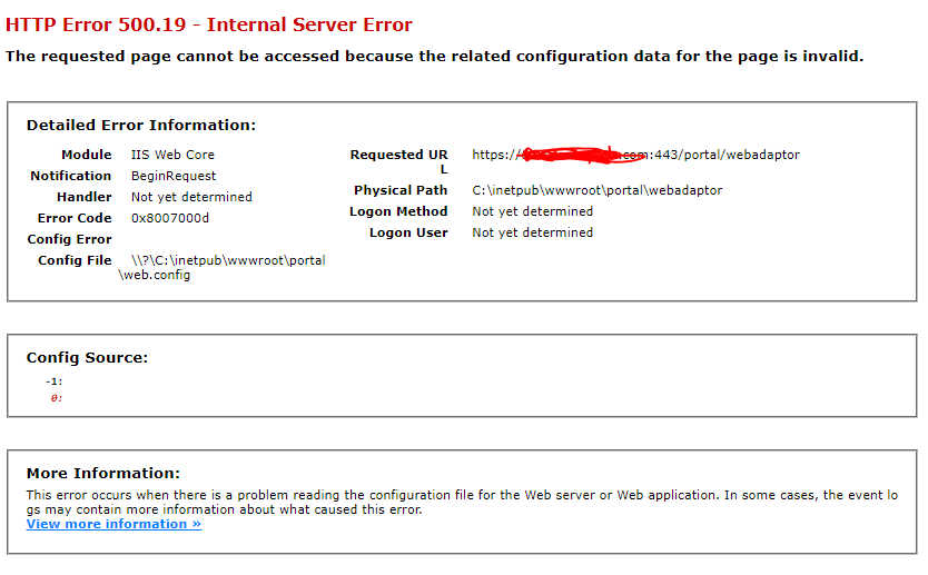

When I try to access the url to configure the adaptor: https://domain.com/portal/webadaptor I get the error:
HTTP Error 500.19 - Internal Server Error
The requested page cannot be accessed because the related configuration data for the page is invalid.

Both display this error:

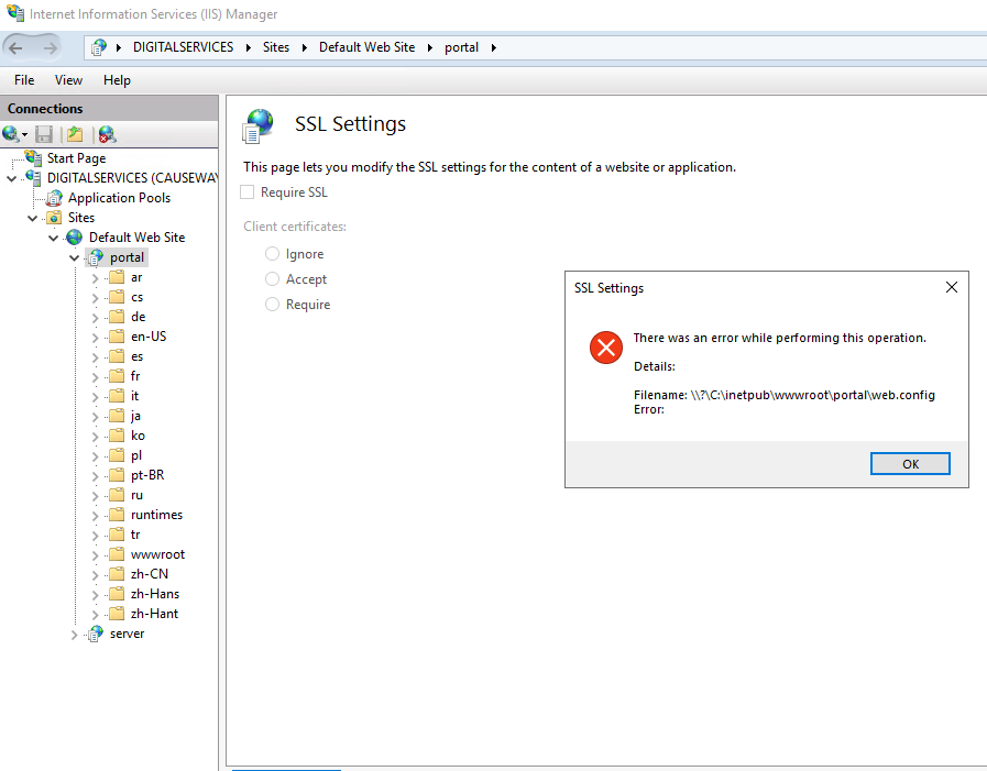

So I'm assuming there is some issue with the web.config file - If I try to edit the edit the settings in IIS I get the following error:
