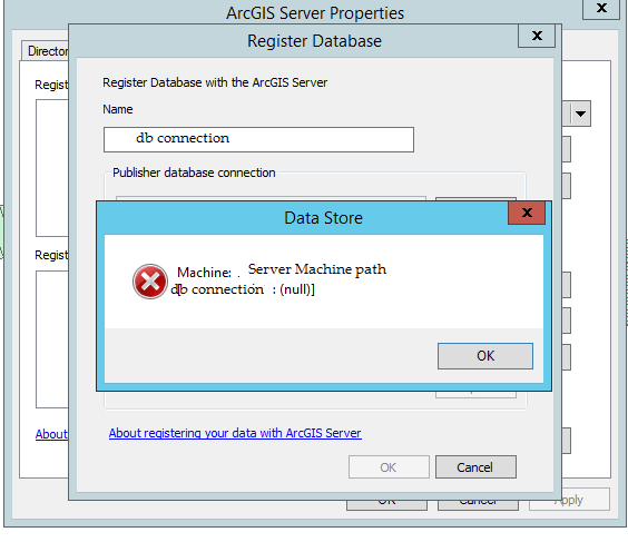

Started having publishing problems on an ArcServer machine, got many add messages about ArcMap on that machine being corrupt and some SQL Native client issues.  All that has been fixed by ensuring proper version of client is installed and the desktop is working correctly - database connections working, adding layers is fine.
However when I go to register the database with the server, I see the following:
Stumped by this one - it seems to be configured the same as our other functioning ArcServer machines and am not sure how to research this error (no code)

Yes, I created new database connections, as well as a new server connection in Catalog, fresh session of arcmap.  All appears normal until I go to register.
Registering the database through server manager fails as well: (I navigated to the sde connection file to import - this is the result.  that database connection works in arcmap)

AllenScully
Did not have those patches installed - installed the Server versions of both this morning and was able to register an SQL Server SDE database and publish successfully.  Looks like that did it.
