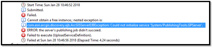

Hi Everyone,
We are using ArcGIS Server 10.4.1 with Oracle 11g. Currently, we are unable publish any map service on the server. We have tried following already:
1) Restarting the ArcGIS Server Service on IIS
2) Checking the ArcGIS Folder permission to see it has the full access
We are getting following error message:
Sometimes we are also getting the following error message:
The GP Results Windows says the following:
Any assistance to resolve this will be appreciated.
AdityarajChavada
Nevermind. I ran a repair on ArcGIS Server and it fixed the issue.

Hi Srihasha! Sorry for the delayed reply. I just ran the setup file for ArcGIS Server and choose the repair option. This did the trick.

Same problem with Ms SQL. This patch helped us: ArcGIS Server Geoprocessing Service Startup Patch

When you check the log of ArcGIS Server you might find this message:
Services containing process crashed
If that's what you see, then check this page:
https://support.esri.com/en/technical-article/000013609
I had to correct the Python Path in the registry, as described. No repair needed. Looks like the Python Path is set incorrectly when performing an upgrade from 10.3 to 10.5.1 (in my case). This only became a problem yesterday. I don't have any clue as to why this problem suddenly appeared though.
