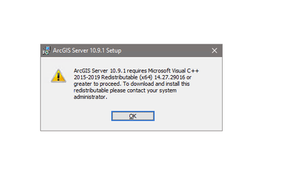

We are currently upgrading our dev environment from 10.8.1 to 10.9.1.
One of our three server machines refuses to acknowledge that MS Visual C++ 2015-2019 etc etc is installed and we are stuck at that dialog. Clicking through tells us that ArcGIS Server failed to install.  We have tried everything from uninstalling 10.8.1 to reg cleans, anti-virus off, newer versions of the redist.  but no go. It refuses to budge.
The three servers were built identically (Mapserver01,Mapserver02, Imageserver01), but this issue for some reason is only on one.
Esri seem to have no solution to bypass it.
Has anyone encountered this issue and were they able to get past it?
Thanks.

I assume the machine in question is verified 64 bit
Brady
Yes, 64. We gave up and rebuilt the server. Pretty quick in a VM environment.
You are not the first to have told us to wait till 11 due to various issues. 🙂 We will not upgrade our production space till a .1 eleven version I guess.
Thanks for the response.

RenatoTeixeira1
I have this same problem, that I cannot solved yet. Tried everything as you told.
There are any ESRI Staff to help us please ??
