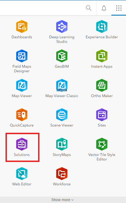

Once you are signed in in Portal on your ArcGIS Enterprise 11.3 you can open the app launcher and you will see a Solutions icon.
Once you click that it will redirect you to the solutions available for your ArcGIS Enterprise deployment. I checked and I was able to deploy Roadway Management.
Let me know if you need more assistance
