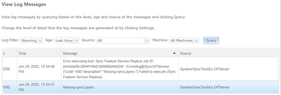

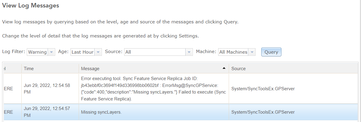

- In guest arcgis server manager log, we see this error:

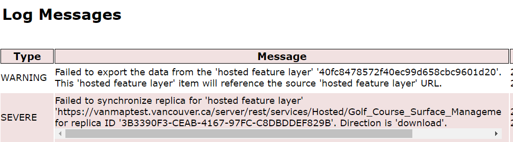

- here is the error in guest Portal log:
