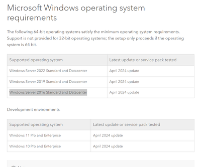

I did notice that 2016 is unsupported. If you try to update a enterprise geodatabase that is sql server 2016, it says unsupported.
https://enterprise.arcgis.com/en/server/latest/get-started/windows/what-s-new-in-arcgis-for-server.h....

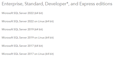

This is the link to the Operating System requirements NOT SQL Server....
SQL Server requirements for 11.3: https://enterprise.arcgis.com/en/system-requirements/latest/windows/database-requirements-sqlserver....
