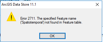

So, somehow somewhere, there is still a lingering connection or property that is telling ArcGIS we have spatiotemporal data store (unconfigured though?). I tried using the REMOVE property from the setup.exe installation file, but it gives that same error about an unconfigured spatiotemporal data store.
Setup.exe /qb ACCEPTEULA=YES USER_NAME=mydomain/myaccount PASSWORD=Mypassw0rd
REMOVE=Spatiotemporal

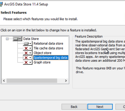

Hi @cjms, I believe this is expected.  When the data store was installed, the spatiotemporal data store component was enabled.  You can try disabling this by going to the control panel > select the Data Store > Change.  Uncheck the Spatiotemporal Data Store:
I would proceed with caution as I haven't tested if this affects the existing data stores installed (i.e. relational).

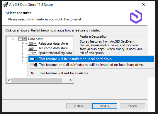

Hi cjm, From control panel- ArcGIS Data Store ,you can select Modify, and select Next.
Select Spatio-temporal datastore and click "The feature will be installed on local hard drive"Screenshot 2025-06-11 153517.png
