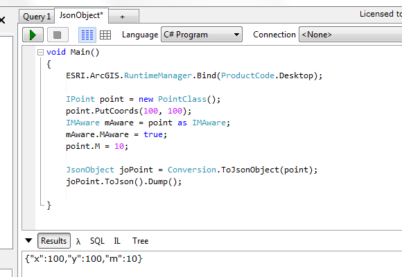

In my SOE project, I need to convert a Point feature to JsonObject.  The related code in my app is below:
IPoint point = gHelp.getPoint(k_Values, coordinate, pPtsColl);
JsonObject onSegPoint = Conversion.ToJsonObject(point);
        List<JsonObject> jsonGeometry = new List<JsonObject>();
The point does have X, Y and M values + geometry, etc.  However, after the conversion to JsonObject, the M value is mission.  How can this problem be solved?  Thanks.
ShaningYu
Honored Contributor
I tried this approach below and the problem got solved.  Thanks for your review.
        JsonObject onPoint = Conversion.ToJsonObject(point);
        onPoint.AddDouble("M", point.M);
nicogis
MVP Alum
ShaningYu
Honored Contributor
Thanks.
