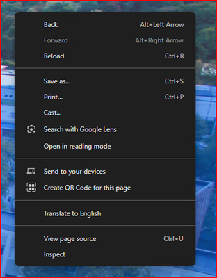

Unfortunately, if I right-click on the Row item in my Sites application, I get this popup:
Not the intended popup described above and found on most web sites (as seen in the image below):
