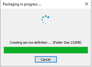

Hi there,
Apologies, this is by publishing directly as a service (not actually creating an .sddraft or .sd file, i just assumed that it creates a .sddraft file as part of the process), it's just when publishing and the publishing dialog says creating service definition that this massive file size appears in brackets after the message. I've just created a .sd file of the service and it's only about 3Mb in size, which is what I would expect. For reference I've republished again and taken a screenshot of the moment during publishing that it says this.
