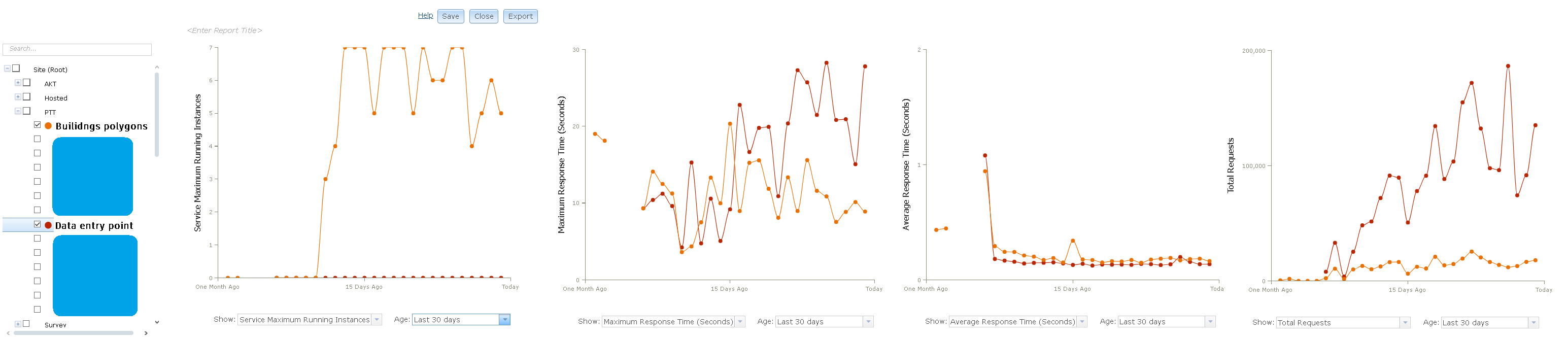

But, when I look to its statistics, I am a little bit confused because of how the graph of Service Maximum Running Instances looks like.
Here is the image of server statistics:
The "Building - Polygon" is acting as background. It is a Map Service which I (accidentally) set the instance to Dedicate (min 3, max 7).
The "data entry - point" is where the actual transaction happenning.    It is a Feature Service where users accessing data via Field Map and Arcgis Pro.

1. Why the Service Maximum Running Instances of "data entry - point" is flat 0, although its Total Request and Maximum Response Time are always higher ? Is it normal ?

Your feature service is using the shared instance pool. There are 0 dedicated instances for that service. That is why the Max number of instances for that service is reported as 0. The requests to that service are being handled by the DynamicMappingHost map service ArcSOCs. By the way at 11.5 you can create a statistics report for the DynamicMappingHost service now... it's under the System folder.
At https://enterprise.arcgis.com/en/server/latest/administer/windows/configure-service-instance-setting... we provide some guidance on when to use the shared instance pool. Namely, we suggest to use shared instance for "services that are infrequently used." Looking at the statistics report you shared, I would suggest this is a very frequently used service that should have dedicated instances.
Also from the reports you shared, it seems at high load on the feature service there are some users that are seeing very poor performance with max response times between 5 to 25 seconds. That could be due to the network latency between ArcGIS Server (although you only said the portal in in the cloud, I assume ArcGIS Server is there too) and the RDBMS and the high load on the shared instance pool.
